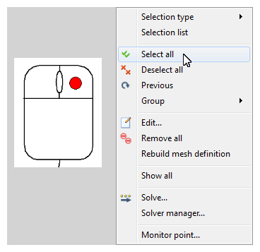

Right click off the model, and click Select all.

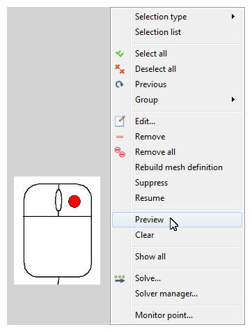

Right click off the model again, and click Preview.
The mesh on every surface of the model is displayed:

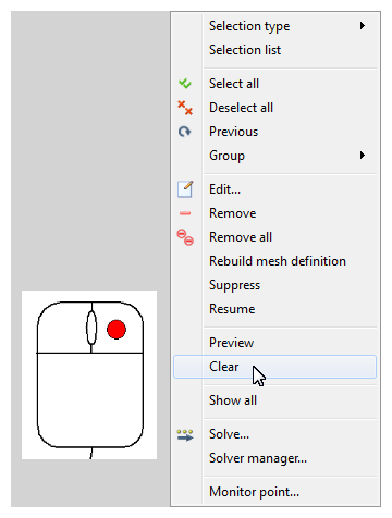

When finished, right click off the model and click Select all. Right click again, and click Clear. This removes the preview display from the model.
