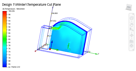

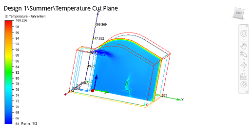

Based on the results, it is clear that the Summer ventilation strategy may not provide the optimum occupant experience, while the Winter strategy seemed to be better.

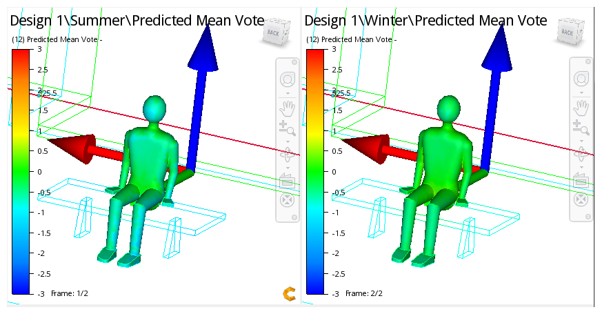

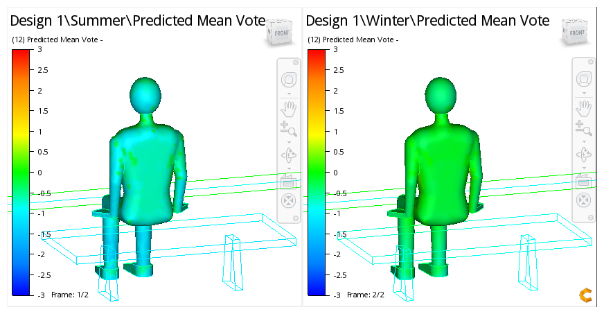

In the summer design day, the occupant's front appears fairly comfortable...
But the back is going to get pretty cold. The winter strategy, however, provides a more comfortable experience for the occupant's back:
The Summary Plot showed a significant temperature gradient (nearly 2 degrees) across the occupant's body in both scenarios:

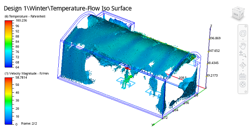

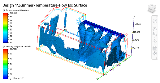

The flow results indicate a strong jet impinging on the occupant's back in the Summer scenario. In the Winter case, the flow circulates about the hall due to buoyancy before engaging the occupant:
