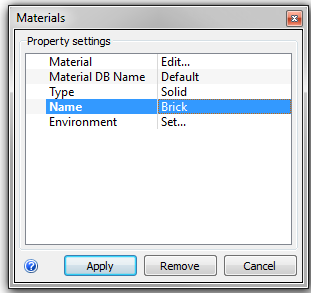

Open the Materials quick edit dialog in ONE of the following ways:
On the Material quick edit dialog, Type = Solid.
Material DB Name = Default.
Name = Brick
Click Apply.
