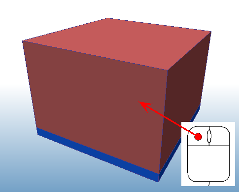

Select the Air part.

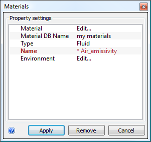

Open the Materials quick edit dialog in ONE of the following ways:
- Click Edit from the toolbar:
- Click Edit from the Materials context panel:
Material DB Name = My Materials
Name = Air_Emissivity
Click Apply.
