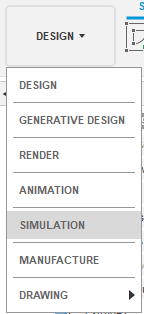

- Select Simulation in the Workspace drop-down menu.
- Select Simplify Model in the New Study window.
