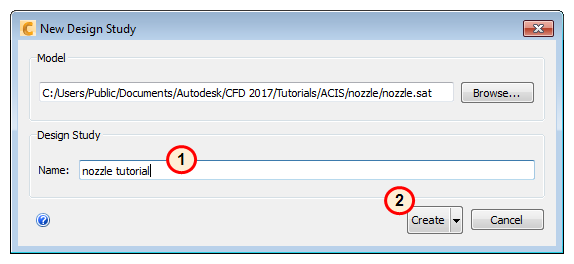

Click New from the Start & Learn tab:
On the New Design Study dialog, click Browse.
On the File manager dialog, navigate to Users\Public\Public Documents\Autodesk\CFD 2023\Tutorials\<file type>\nozzle.
Click Open.
Autodesk® CFD starts, and creates the Design Study for the tutorial.
