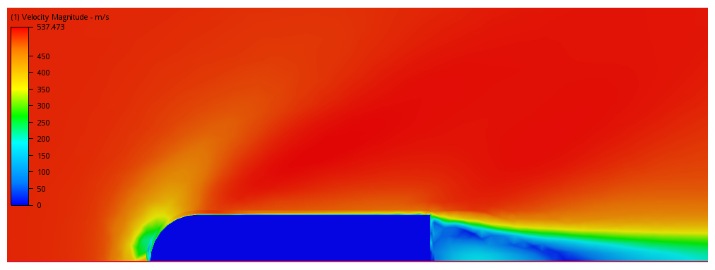

Make sure the Global Result (on the Global context panel) is set to Velocity Magnitude:
Zoom in close to the bullet:

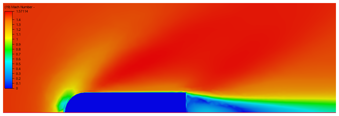

Select Mach Number from the Global Result menu on the Global context panel:

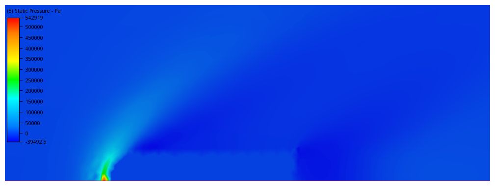

Select Static Pressure from the Global Result menu on the Global context panel:
