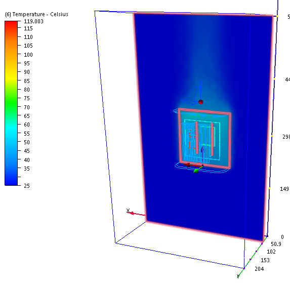

Click Planes from the Results tab:

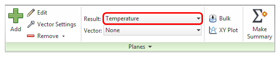

To display a temperature results plane, select Temperature from the Result menu on the Planes context panel.
Right click on the plane, and select Shaded, if the plane is not visible.
To move the plane, drag the triad axis normal to the plane.
To hide the contours, right click on the plane, and select Outline.

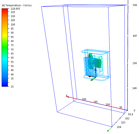

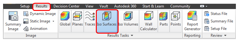

Click Iso Surfaces on the Results tab:
To create an Iso Surface, click Add on the Iso Surfaces context panel:
To display a temperature iso surface, select Temperature from the Quantity and Color by menus on the Iso Surfaces context menu.
To delete the iso surface, right click on it, and select Remove
