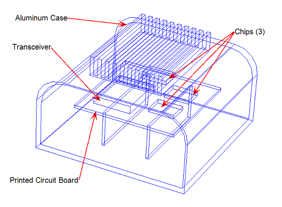

In this tutorial, we simulate the air flow and temperature distribution due to natural convection in and around a sealed telecommunications module.
The aluminum enclosure contains several heat-generating components. The flow around the module is driven by gravity and density variations caused by gradients in the air temperature. (This is also known as buoyancy.) Fins on the exterior of the enclosure dissipate heat to the surrounding air.
After opening the module geometry in Autodesk® CFD, we construct a large air environment using the External Volume Geometry Tool. Because the device is in an open environment, we assign flow conditions to the top and bottom surfaces of the box. We also assign an ambient temperature to the lower opening.
