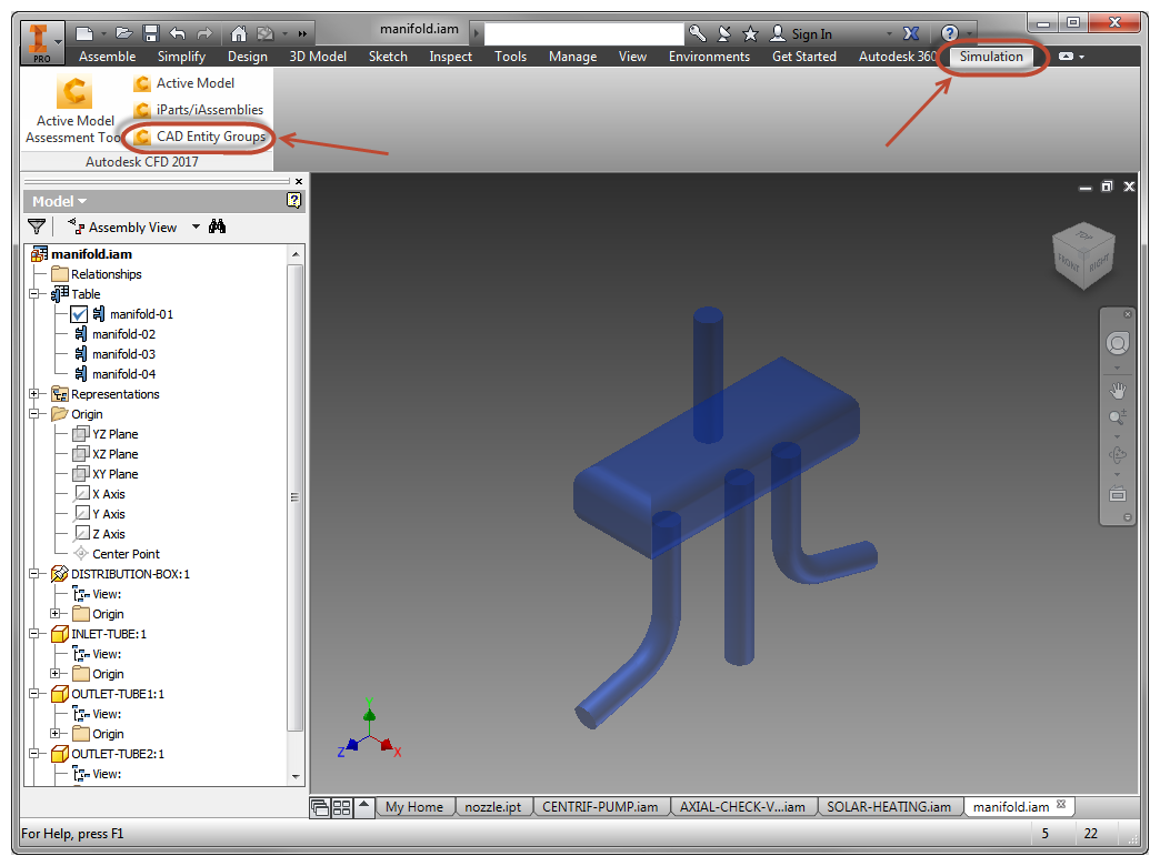

Click the CAD Entity Groups command.
For example, if you are launching from Autodesk® Inventor, click Simulation and CAD Entity Groups:

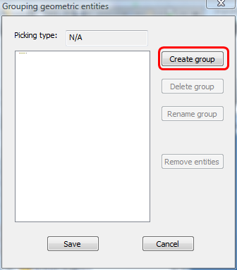

Click Create group.

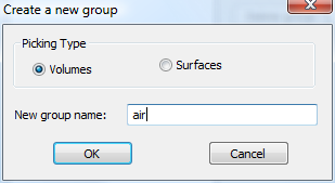

Select Volumes. Enter "Air" for the group name.
Click OK.

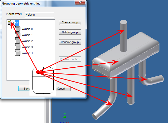

Click the air group, and select the five parts in the model.
Click Save.
