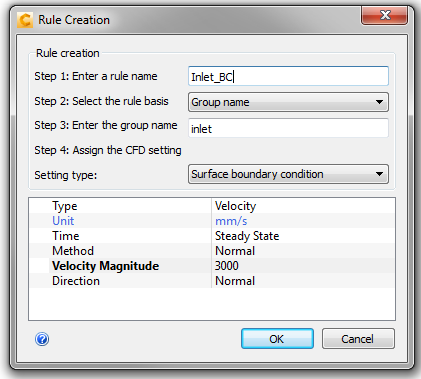

Expand the Launch panel, and select Rules.
Click Click to create a rule
Step 1: Specify the rule name to be "Inlet_BC"
Step 2: Set the rule basis to be Group name
Step 3: Specify "inlet" as the group name
Step 4: Select Surface boundary condition as the Setting type
Type = Velocity
Units = mm/s
Velocity Magnitude = 3000
Click OK.

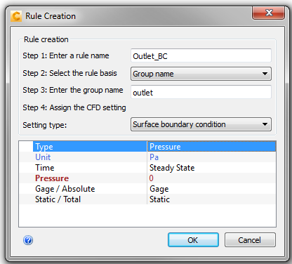

Step 1: Specify the rule name to be "Outlet_BC"
Step 3: Specify "outlet" as the group name
Type = Pressure
Unit = Pa; Pressure = 0
Click OK.

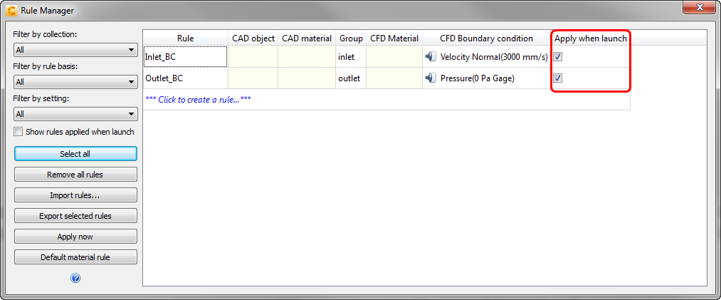

Check the Apply when launch box for both rules.
Close the Rule Manager dialog.
