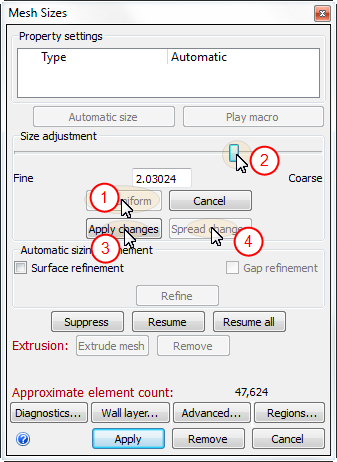

To modify the mesh sizing, do ONE of the following:
Click the Use Uniform button
Adjust the Size Adjustment slider to approximately 2
Click Apply changes.
Click Spread Changes.
