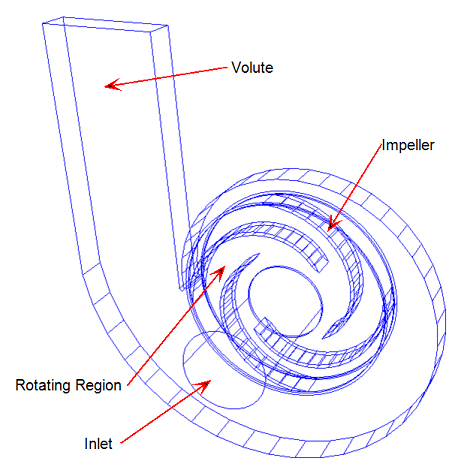

In this tutorial, we simulate the flow in a centrifugal pump with back-swept blades. The model consists of the volute, the inlet pipe, the impeller, and the rotating region:

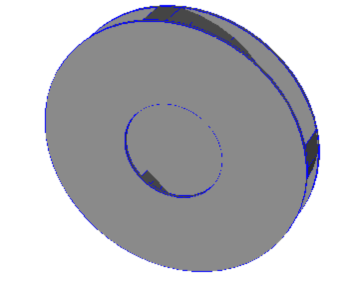

The rotating region is a volume that completely surrounds the impeller, and is the interface between rotating components and surrounding stationary objects.
This is the rotating region:

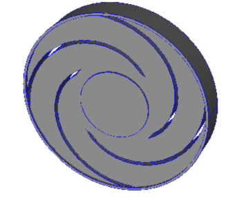

For reference, this is the impeller:
