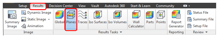

Click the Results tab.

Click Planes from the Results tab:

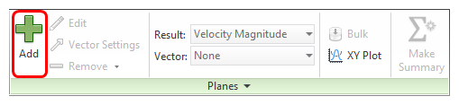

To create a Plane, click Add on the Planes context panel:
