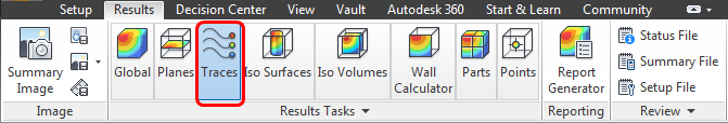

Click Traces from the Results tab:
In the Traces context panel, set the Seed Type to Rectangular, and the Seed Pattern to Grid. Click Add.
