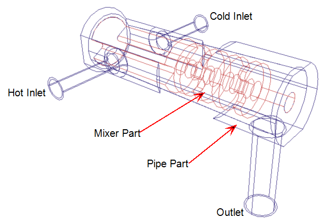

In this tutorial, we study water flow through a simplified household faucet. A hot stream and a cold stream enter the faucet, combine in the mixing region, and exit through the outlet.
The CAD model is composed of two solid parts. We will use the Autodesk® CFD Geometry tools to create the internal part for simulating the water. The pipe and mixing divider are made of copper.
