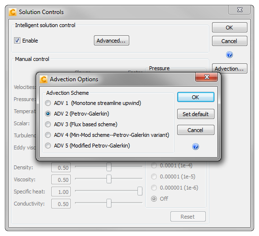

On the Solve dialog, click Solution Control, and click Advection. On the Advection Options dialog, select ADV2. Click OK, and OK on the Solution Controls dialog.

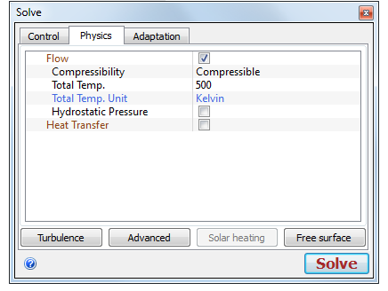

Click the Physics tab.
Flow = On
Compressiblity = Compressible
Total Temp. = 500
Total Temp Unit = Kelvin

Click Solve to start the analysis.
