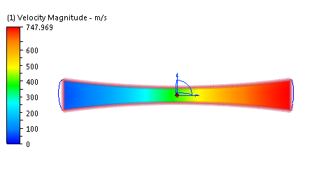

In this step, we examine the velocity results using a cutting plane and vectors.
Cut planes show results on a slice through the model. Use them to gain a comprehensive understanding of the flow. Use vectors to show the velocity direction and magnitude throughout the device.
Click Planes from the Results tab:
To create a Plane, click Add on the Planes context panel:
To orient the plane, left click on it, and click this icon from the context toolbar:

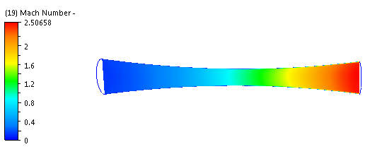

To display Mach number, select Mach Number from the Result menu on the Planes context panel.
