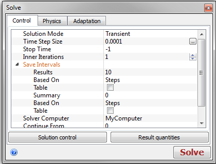

Click the Control tab.
Verify that Solution Mode = Transient, and that Inner Iterations = 1
Time Step Size = 0.0001
Results Save Interval = 10
Time Steps to run = 100
solve dialog

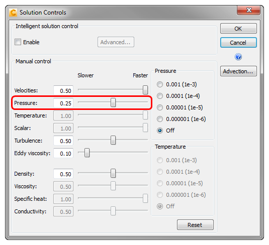

Click the Solution Control button, and move the Pressure slider to 0.25
pressure slider
Note: This improves the stability of the calculation. We recommend this step for flow-induced motion analyses.
