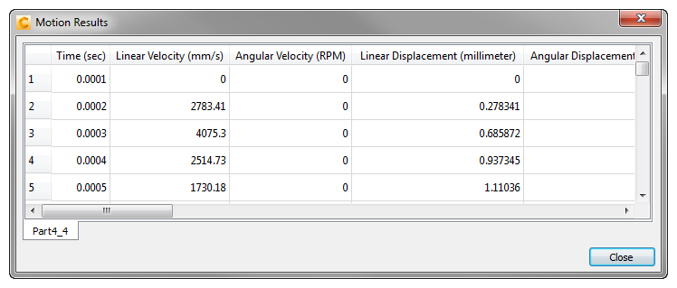

In this step, we use the Motion Results table to determine the time history of the displacement and force on the poppet. This table contains a complete history of the velocity, displacement, force, and torque of the moving solid.
From the Results tab, expand the Review menu. Select Motion Results
Examine the Linear Displacement column to see the progression of the valve with time.
Examine the Force column to see the history of the force on the poppet with time.
Click Close.
