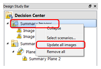

To start comparing results, click the Decision Center tab:
In the Decision Center, right click on the Summary Images branch, and click Update all images.

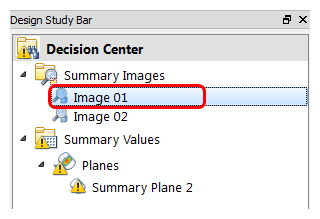

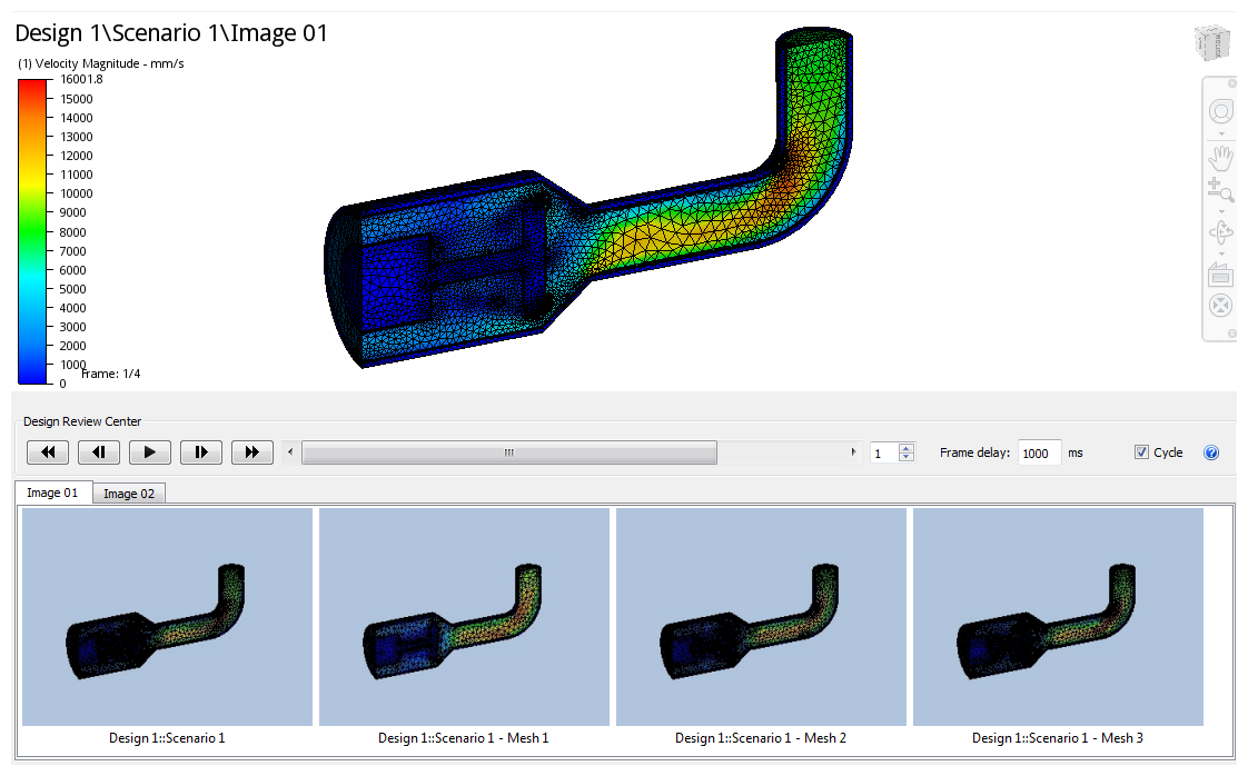

The Design Review Center tab of the Output bar should be active. Click Image 1 to show the mesh summary image:
To compare the four meshes, use the slider and "VCR" controls in the Design Review Center.
