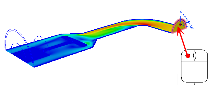

To create a Plane, click Add on the Planes context panel:
To create a plane at the inlet, left click on the plane, and click the Surface Align icon. Select the inlet surface.
To make the plane a Summary Plane, click Make Summary in the Planes context panel:
