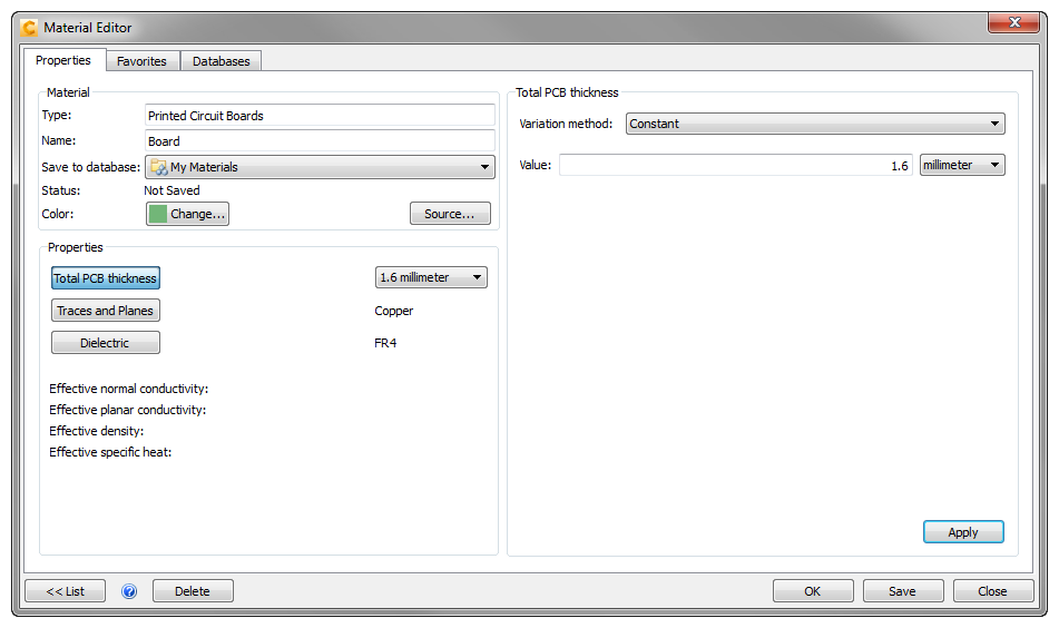

Click the Total PCB Thickness button.
Value = 1.6; Units = millimeter
Click Apply.

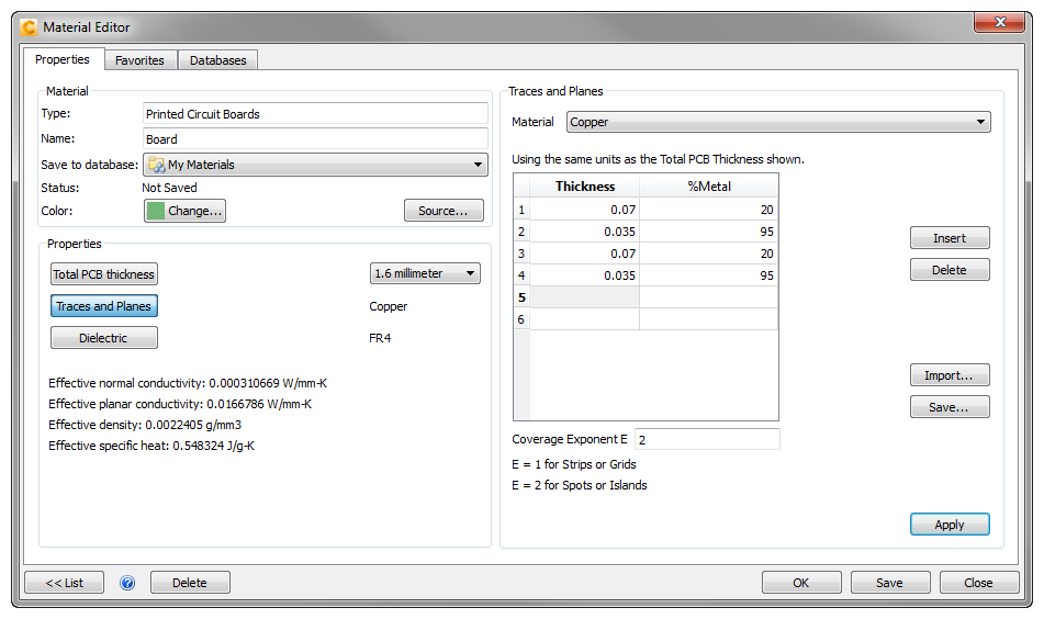

Click the Traces and Planes button
Material = Copper
Layer 1: Thickness = 0.07; %metal= 20
Layer 2: Thickness = 0.035; %metal = 95
Layer 3: Thickness = 0.07; %metal = 20
Layer 4: Thickness = 0.035; %metal = 95
Delete all data points on rows after Layer 4.
Coverage Exponent = 2
Click Apply.
