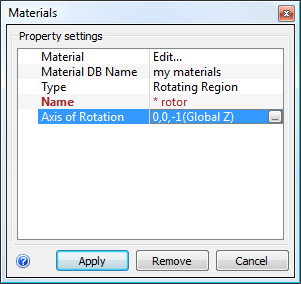

Select the rotating region
Open the Materials quick edit dialog in ONE of the following ways:
Material DB Name = My Materials
Type = Rotating Region
Name = rotor
On the Axis of Rotation line, click the ... button
Click Z, and the -/+ button
Click Apply.
