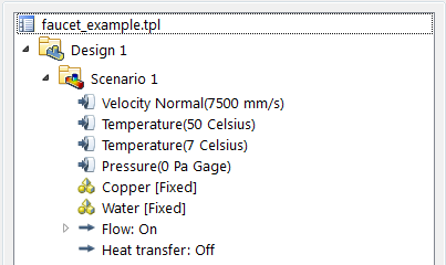

The model contains a velocity, two temperature, and a pressure boundary condition.

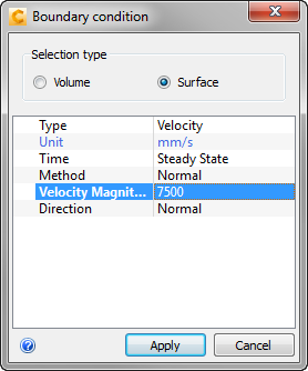

To create the velocity boundary condition:
Right click on Scenario 1, and click Add boundary condition...
Type = Velocity
Units = mm/s
Velocity Magnitude = 7500
Click Apply.

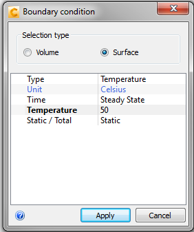

To create the temperature boundary conditions:
Type = Temperature
Units = Celsius
Temperature = 50
Click Apply.

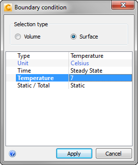

Type = Temperature
Units = Celsius
Temperature = 7
Click Apply.

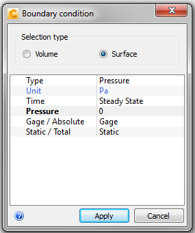

To create the outlet pressure boundary condition:
Type = Pressure
Unit = Pa; Pressure = 0
Click Apply.
