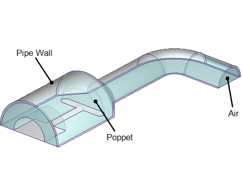

The analysis geometry consists of three parts: the outer pipe wall, the poppet, and the air:
