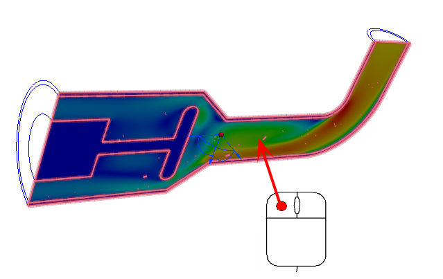

Left click on the plane, and click the Surface Align icon. Select the symmetry surface.
