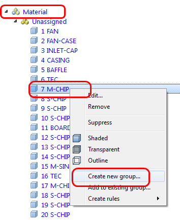

On the Design Study Bar, expand the Material branch. Right click on one of the parts called M-Chip, and select Create New Group.
On the Add to Group dialog, enter "medium chips" as the group name. Leave the Type as Geometric.
Click OK.

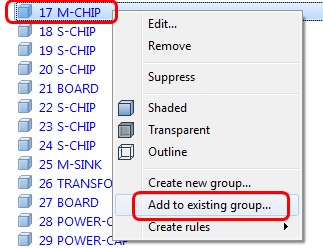

Right click on the other M-CHIP part from the list, and select Add to Existing Group.
Select the medium chips group.
Click OK.
