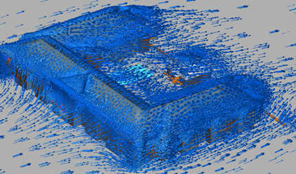

Wind Loading
Wind loading analyses simulate the air flow and resultant structural loading on buildings, large signs, and other structures. Examples include:
Application Examples
Flow Over and around buildings
Wind Loading on windows, signs, lightboards, and façades

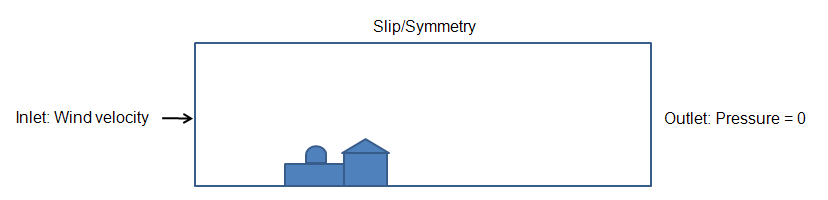

A volume surrounding the device must be constructed. In most cases the surrounding volume is an open environment:
- Add this volume either in the CAD model or in Autodesk® CFD with the External Volume tool. (We recommend creating it in the CAD model so the volume can be coplanar with the ground-plane of the structure.)
- Build the environment geometry using these recommended relative dimensions:

The boundary conditions for wind loading analyses are straightforward:
- To define the inlet of the air volume, assign the wind speed as a Velocity boundary condition.
- To define the outlet of the air volume, assign Static Gage Pressure = 0.
- If the air region simulates a free-space environment (not a wind-tunnel), assign Slip/Symmetry to the top and sides of the region. (Do not specify a condition on the ground plane, because the air does not physically move along the ground plane.)
