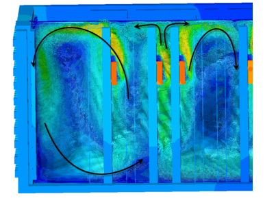

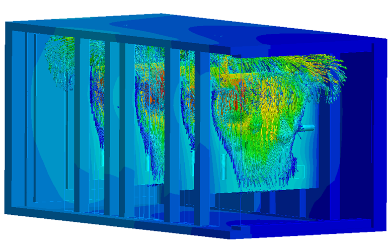

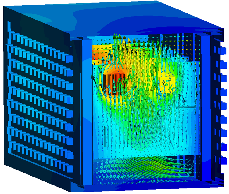

Components within a sealed, passive device are cooled by natural convection, conduction, and radiation. Temperature variations in the air cause density gradients, which in turn cause the air to move. Air cannot leave the device, so all heat transfer occurs through the casing. The air movement, conduction, and radiation transfer heat from heated components to the surrounding environment.
Flow in a passively cooled, sealed device is often laminar, and radiation plays an important part in removing heat.
