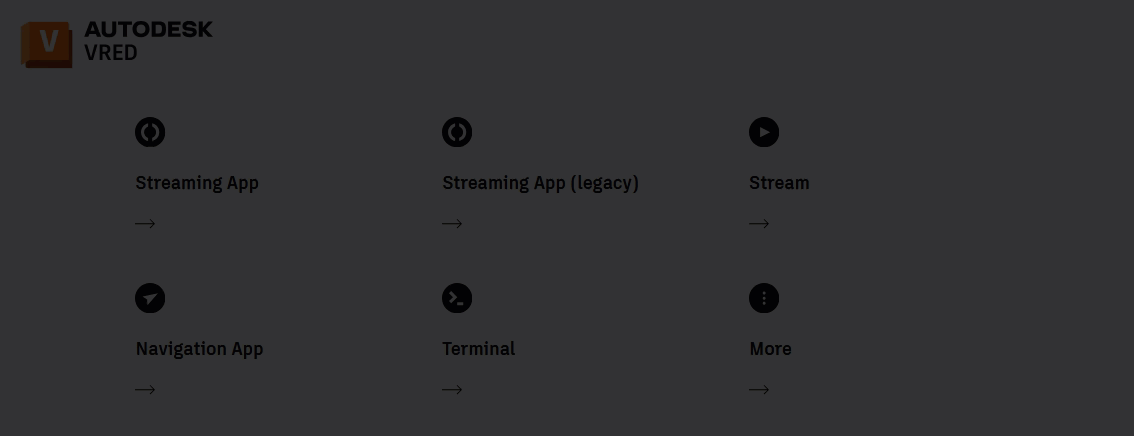

Access the Autodesk Terminal to use VRED as a terminal application by selecting Terminal in the web interface. This opens the VRED Hub terminal for scripting in the web interface instead of switching back to your local machine.
Autodesk Terminal
Using the Terminal

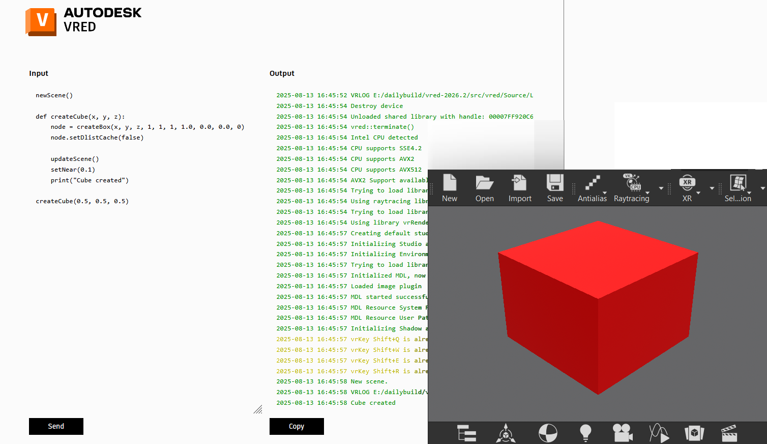

  5. In the Input section, enter some code. For example, to create a red cube that is 0.5 units, you would enter:
    newScene()
    def createCube(x, y, z):
        node = createBox(x, y, z, 1, 1, 1, 1.0, 0.0, 0.0, 0)
        node.setDlistCache(false)
        updateScene()
        setNear(0.1)
        print("Cube created")
    createCube(0.5, 0.5, 0.5)
  6. Scroll down the page and click Send. The Output section and viewport update.
