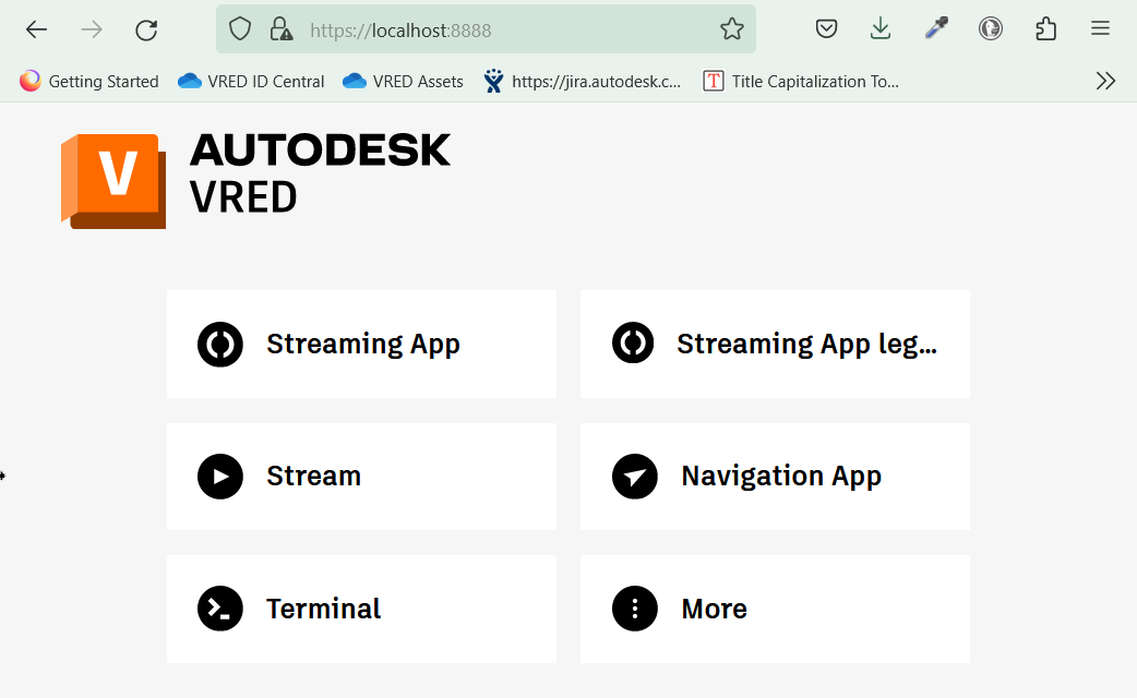

The Web Interface (think of it as the web server) is the web browser interface that communicates with VRED via the HTTP protocol (localhost:8888). Access VRED through any modern web browser, without the need for plugins or specific software installations. Now, it's easier for a wider audience to participate in design reviews and interact with the 3D visualizations.
The web browser interface is provided by a built-in web server, which is a remote procedure-call API (RPC API) that is built on the same base as the Python API v2, and accessible via JavaScript. Use it to access the following:

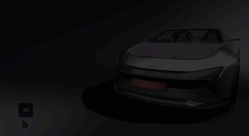

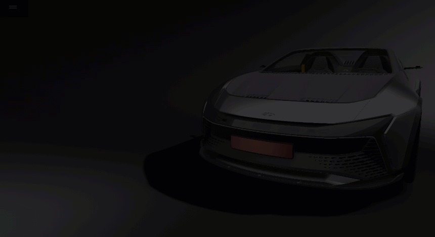

Streaming App - Opens the Streaming App to live streams rendered images from the VRED renderview, using the provided controls to switch viewpoints and variants. This is for users running VRED 2024 or newer. It is optimized for mobile devices and was created to replace the legacy version. See Using the VRED Streaming App for further details.
Streaming App legacy - Opens the version of the Streaming App available before VRED 2024 for users running VRED 2023 and older.
Stream - Opens a live stream of the VRED viewport displaying an HD version in the browser. Choose from the following:
H264 HD - Opens a live stream of the VRED viewport displaying an H264 HD version in the browser.
JPEG HD - Opens a live stream of the VRED viewport displaying a JPEG HD version of the scene image in the browser.
Navigation App - Opens the VRED App to navigate your VRED scene and switch between variant sets, using a network-connected device, such as a tablet or phone, as a remote control.

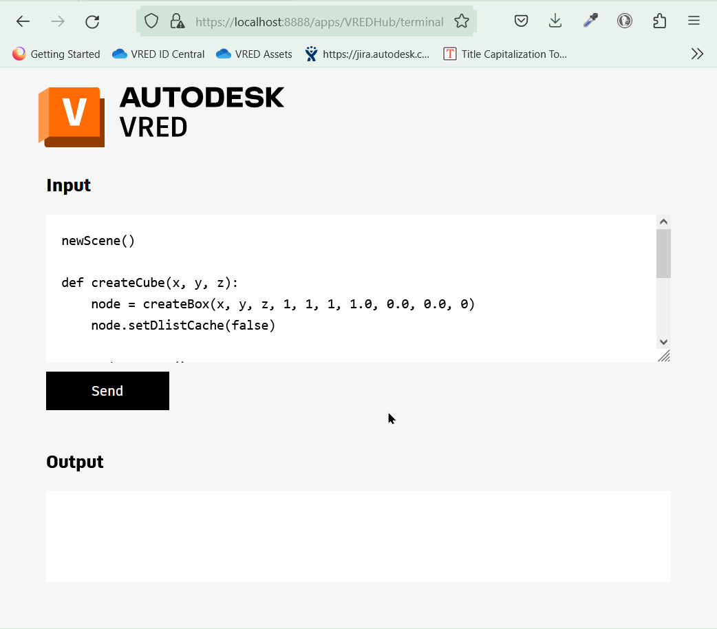

Terminal - Opens the VRED Hub terminal for scripting in the web interface, instead of switching to VRED on your local machine.

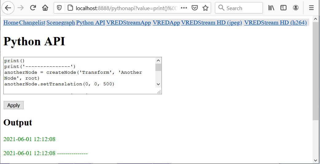

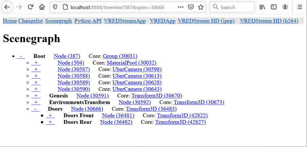

More - Provides a list of options to access a web interface for the Scenegraph (http://localhost:8888/treeview) and Python API (http://localhost:8888/pythonapi). Use the functions and parameters found in Python API v2 documentation for the web interface and Python API.
The ChangList option accessible through clicking
More is legacy functionality that will be removed in the future.

How to Open the Web Interface
With a scene loaded into your version of VRED, in a browser, enter localhost: followed by the port number set in the preferences. For example, the default port is 8888; therefore, in the browser, you would enter localhost:8888 to access the Web Interface.
