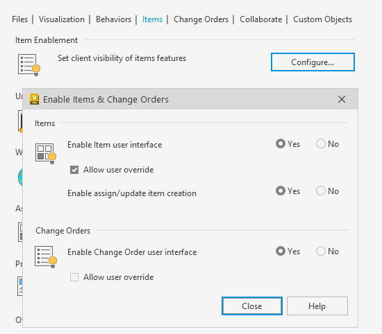

Disable the Items feature or give users the ability to override the disablement on the Enable Items and Change Orders dialog box.
Click Tools > Administration > Vault Settings.
In the Vault Settings dialog, select the Items tab.
In the Item Enablement section, click Configure. The Enable Items and Change Orders dialog provides options for controlling Items access.
Select the No option to disable Items.
Select the Allow user override check box to let users override the disablement. The override is performed on the Options dialog for the application settings.
You can control if users are disabled to assign or update items in Vault Client and Inventor. Select the No option for Enable assign/update item creation option to disable users to assign or update items in Vault Client and Inventor using the context menu option in the "Uses" and "Where Used" tabs of the "Show Details" dialog.
Click Close.
