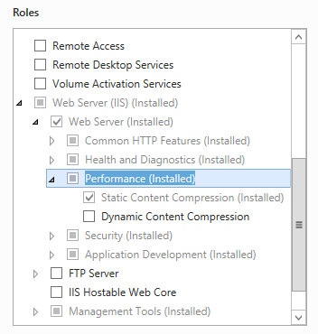

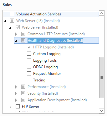

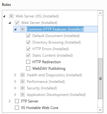

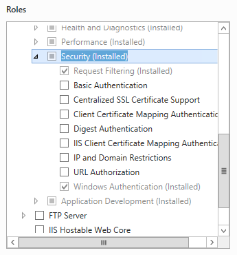

On the Server Roles section, select the following Roles:
