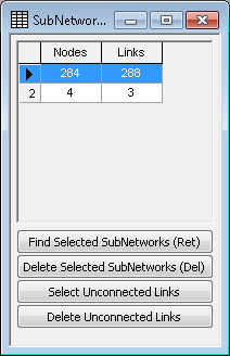

The Connectivity Trace View lists details of all the separate sub-networks within a model. The view also allows selection of unconnected links.
The Connectivity Trace View is displayed by selecting GeoPlan
Tracing tools
Connectivity trace.
Select the objects in listed sub-networks by selecting one or more rows on the
Connectivity Trace View. The objects are selected on the
GeoPlan Window and the other network views.
The buttons at the bottom of the view act as follows:
- Find Selected SubNetworks (Ret): enabled when one or more sub-networks is selected in the Connectivity Trace View grid. Click this button, or use the keyboard Return key, to select all objects in the selected sub-networks and zoom in on the sub-networks on the
GeoPlan Window.
- Delete Selected SubNetworks (Del): enabled when one or more sub-networks is selected in the Connectivity Trace View grid. Click this button, or use the keyboard Delete key, to delete all the objects in the sub-networks selected in the Connectivity Trace View grid.
- Select Unconnected Links: enabled when links that have missing nodes at both ends of the link are present in the network. Click this button to select all links that have missing nodes at both ends of the link.
- Delete Unconnected Links: enabled when links that have missing nodes at both ends of the link are present in the network. Click this button to delete all links that have missing nodes at both ends of the link.
