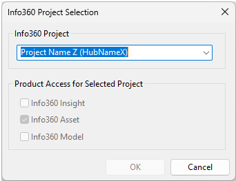

Info360 Project Selection dialog
If you are accessing the Prepare for Info360 option for the first time, it will open this dialog which will connect you to Info360 in the cloud.
This dialog loads a list of available projects that you have access to, which you can select from the drop-down list.
The hub name for the particular project is in parenthesis.
When you select a project, the Product Access for Selected Project gives read-only information on what product the selected project can access (Info360 Insight, Asset, or Model). Some projects may have access to multiples Info360 products.
The OK button is only enabled if the project has suitable access for the required operation.
