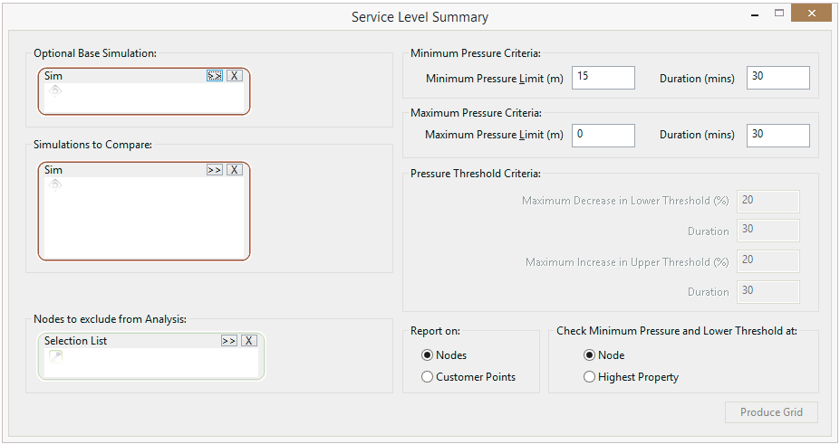

The Service Level Summary dialog is used to produce a grid report of counts of failures to meet defined service levels for a selection of simulations. The dialog is displayed when Results Grid reports Service level summary is selected, or when the base simulation of a critical link analysis run is dragged into the workspace.
Grid Report Dialog
See Producing Service Level Reports for more details.

Optional Base Simulation
Base simulation/s against which simulation to be reported on will be compared.
If a base simulation is selected, only nodes or customer points that failed level of service criteria in the base simulation but not in the simulation to compare will be reported in the grid.
Nodes or customer points that failed level of service criteria in both the base simulation and the simulation to be compared will not be reported.
Simulation / Simulations to Compare
Simulation/s for which the grid report is to be produced.
If a simulation is open, this field will automatically be populated with the current simulation.
For summary reports, multiple simulations can be added.
Nodes to exclude from Analysis
A selection list of nodes that will not be tested for failures against the demand criteria (if applicable) or pressure threshold criteria.
Minimum Pressure Criteria
The target minimum pressure and allowable duration. If the pressure falls below this target for a period longer than the Duration (where duration is cumulative over the length of the simulation), a failure is reported.
The default values of the Minimum Pressure Limit and Duration fields are those set in the Service Levels page of the Options dialog.
If a critical link analysis or shutdown simulation is open, these values will be populated with the minimum pressure criteria used for that simulation.
Minimum pressure criteria checks will not be carried out if a zero is entered in the Duration field.
Include Nodes without Demand
Not applicable to summary reports.

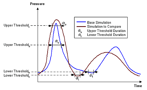

Pressure Threshold Criteria
The allowable percentage difference between lower and upper pressure thresholds of the Simulation to Compare and the Base Simulation. If the percentage difference exceeds these criteria, a failure is reported.
The default values of the Pressure Threshold Criteria fields are those set in the Service Levels page of the Options dialog.
If a shutdown simulation is selected, the Pressure Threshold Criteria fields will be populated with the pressure threshold criteria used for that simulation.
  • Lower threshold at a node is calculated as the lowest pressure experienced during the simulation for at least the specified duration (where duration is a continuous period; that is, not cumulative).
  • Upper threshold at a node is calculated as the highest pressure exceeded for at least the specified duration.
  • Percentage difference is calculated as:
    • (Upper Thresholdc - Upper Thresholdb)/Upper Thresholdb
    • (Lower Thresholdb - Lower Thresholdc)/Lower Thresholdb
Pressure threshold checks will not be carried out if a zero is entered as the threshold value.
Report on
Options to report on either nodes or customer points.
Check Minimum Pressure and Lower Threshold at
Available only if Report on: Nodes has been selected.
If you are creating a node report, and have set the highest property for each node, you can use this additional information and create service level reports either for the nodes or for the highest property served by each node.
Include columns for Demand and Leakage
Check this box to include Average Demand and Average Leakage values in the Service Level Grid view.
Show clusters of Service Level failures
Check this box to display a Clusters grid containing details of clusters of node or customer point failures.
Produce Grid (button)
From the Service Level dialog: Produces the Service Level grid.
From the Service Level Summary dialog: Produces the Service Level Summary grid
