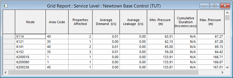

Grid Report (Service Level) view
This view displays a report of all failures to meet the required service level.
The types of report that can be produced are:
Notes:
The view is displayed by selecting Results Grid reports Service level, then completing the Service Level dialog. The fields displayed in the grid depend on the options selected on the dialog.
Item Description
Service level report fields
Column Description Report on Node Report on Customer Point
Node Highest Property
Node
ID of node where a Level of Service failure has occurred
YES
YES
YES
Name
Name of node where a Level of Service failure has occurred
YES
YES
YES
Area Code
The Area Code to which that node belongs
YES
YES
YES
Customer Point
The name of the Customer Point.
The Customer Point cell will be highlighted blue if the customer is a Key Customer.
This field is displayed only if the Report on: Customer Points option is selected on the Grid Report (Service Level) dialog
YES
YES
YES
Using Elevation At
This field is displayed only if the Report on: Customer Points option is selected on the Grid Report (Service Level) dialog.
The field shows which elevation was used:
  • Node
  • Customer Point
NO
NO
YES
Properties Affected
The number of properties supplied from the node which are affected by the failure
YES
YES
NO
Average Demand
The average demand at the node during the simulation.
This field is only displayed if the Include columns for Demand and Leakage option is checked on the Grid Report (Service Level) dialog.
YES
YES
NO
Event Demand Change (%)
Percentage reduction in demand when comparing against a base simulation.
YES
YES
YES
Demand Efficiency (%)
Ratio of Actual to Nominal Demand (averaged over the simulation).
This field is displayed only when comparing simulation results to a base simulation.
YES
YES
YES
Average Leakage
The average leakage at the node during the simulation
This field is displayed only if the Include columns for Demand and Leakage option is checked on the Grid Report (Service Level) dialog.
YES
YES
NO
Min Pressure
The minimum pressure reached during the simulation if pressure dropped below the Minimum Pressure Limit for the specified Duration
N/A if pressure does not fall below Minimum Pressure Limit.
YES
YES
YES
Min Cumulative Duration
The total duration during the simulation when pressure dropped below the threshold
YES
YES
YES
Tested At
This field is displayed only if the Highest Property option is chosen on the Grid Report (Service Level) dialog.
Elevation at which minimum pressure was tested. The field value may be:
  • Node: If the node does not have a highest property
  • Highest Property
  • N/A: If the node/highest property has not failed the minimum pressure threshold
NO
YES
NO
Max Pressure
The maximum pressure reached during the simulation if the Maximum Pressure Limit was exceeded for the specified Duration.
N/A if pressure does not exceed Maximum Pressure Limit.
YES
YES
YES
Max Cumulative Duration
The total duration during the simulation when pressure exceeded the threshold.
YES
YES
YES
Base Lower Threshold
Calculated from the base simulation.
The lowest pressure experienced at the node or customer point for at least the specified duration.
YES
YES
YES
Lower Threshold
Calculated from the simulation to be compared.
YES
YES
YES
Lower Threshold Change (%)
The percentage difference between the Lower Threshold and the Base Lower Threshold.
YES
YES
YES
Lower Threshold Time Of Onset
Simulation time at which the Lower Threshold value was reached.
YES YES YES
Base Upper Threshold
The highest pressure experienced at the node or customer point for at least the specified duration.
YES
YES
YES
Upper Threshold
YES
YES
YES
Upper Threshold Change (%)
The percentage difference between the Upper Threshold and the Base Upper Threshold.
YES
YES
YES
Upper Threshold Time Of Onset Simulation time at which the Upper Threshold value was reached. YES YES YES
