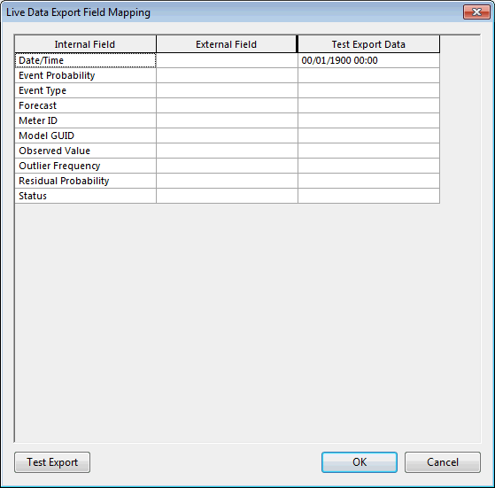

This dialog allows users to map InfoWorks WS Pro internal fields to the fields of the database the results are to be exported to (referred to as external fields).
Only mapped fields will be exported. The export will actually take place in IWLive Pro Operator Client.
The dialog is displayed in either of two ways:
in the Field Mapping column of the Live Data Export view of the Live Data Configuration grid
The options available on this dialog are described in the table below.
| Field | Description |
Internal Field |
InfoWorks WS Pro field name. Fields present in this column depend on the result type (normal simulation results, PressureWatch, QualWatch, etc.). |
External Field |
Field of the database. |
Test Export Data |
Test column. Enter test values in this column before testing the export. |
Test Export |
Click this button to test the export. Check the export by looking in the external database. |
OK |
Close the dialog and commit the changes. |
Cancel |
Abort mapping and close the dialog. |
