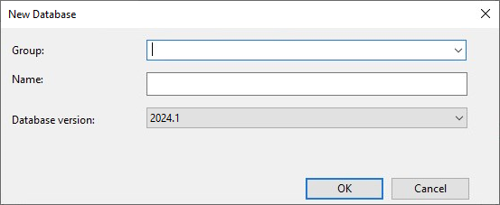

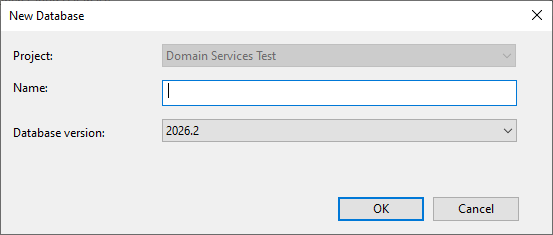

The New Database dialog is used to:
Select or create a new group to which on-premise databases can belong.
Specify the name for a new cloud or on-premise database.
Select the version of the database that is to be used to create the new cloud or on-premise database.
It is displayed when the New button is selected in the Open Database dialog.
Cloud Database
Workgroup Database
| Item | Description |
| Project |
Note: Displayed for cloud databases only.
A drop-down list that displays the projects for the selected hub that you have access to. |
| Group |
Note: Displayed for on-premise workgroup databases only.
The name of a group. The names of groups already defined are contained in the drop-down list. |
| Name | The name of a database. |
| Database version |
The database version for the new database. The available versions are listed in the drop-down list. Note: The oldest version available is 2023.0.
| OK | Saves any changes and closes the window. |
| Cancel | Cancels any changes and closes the window. |
