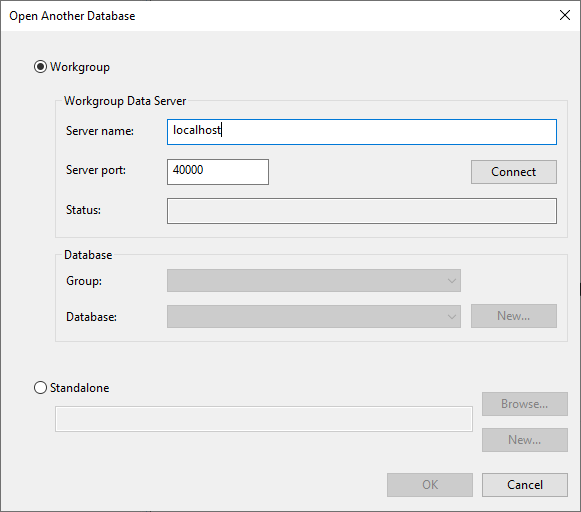

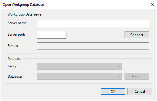

Workgroup Database
Group Description
Workgroup Data Server
Server name:
The name of the machine hosting the database. This can be localhost to automatically find a server on the current computer.
Server port: The machine port used to connect to the database. Typically 40000 for a local host.
Connect Attempts to connect to the server.
Status
(read-only) Reports whether the connection to the server is successful, and shows information about the server (for example Success: SuperNumbat 7.5.0.15001 Snapshot 20160712_2000 Jul 2016)
Database
Group
If databases have been assigned to groups, selecting the group here will show only databases in that group (in the drop-down list below).
Groups are created at the same time as creating a database (see New, below).
Database
If a connection has been made to a server, this lists the databases available on that server.
If a group is selected in the Group drop-down, this list will show only the databases in that group.
You can choose one of the listed databases, or you can create one using the adjacent New button, described below.
New
Opens the New Database dialog, in which you can:
  • Select or create a new group to hold databases.
  • Specify the name for a new database.
  • Select the version of the database that is to be used for the new database. The available versions are listed in the drop-down list.
Update to
Displayed when updating a database.
Lets you choose which version of the database that you want this database to be updated to. The available versions are listed in the drop-down list.
Note: The oldest version available is 2023.0.
Standalone Database
Field Description
(text box - read only) Shows the name of the standalone database, if one has been selected.
Browse Opens a standard Windows Open dialog that you can use to find an existing standalone database.
New Opens a standard Windows Save As dialog with a suggested location and name for a new standalone database. You can change the location and name if you want to.
Update to

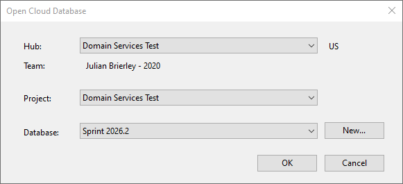

Cloud Database
Field Description
Hub A drop-down list that displays the hubs of all existing cloud databases.
Project A drop-down list that displays the projects for the selected hub that you have access to.
Database A drop-down list that displays the names of all existing cloud databases.
New Opens the New Database dialog, in which you can specify the name for a new cloud database.
Update to
