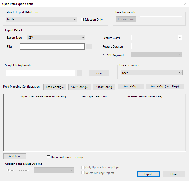

Table to Export Data From
Table dropdown list
For selecting a table to export data from.
Unlike the
Open Data Import Centre, this does NOT include arrays within tables. These are handled in a different way by the Export Centre.
There are two additional options - All Nodes and All Links. If these are selected then all nodes and all links will be exported, or all selected nodes or links if the Selection only option is selected. If either of these options is selected then all fields available for one or more node or link types will be available. If a field is selected in the field list which is not available for one or more node or link types, then that field will be blank whenever a node or link for one of those types is exported.
Selection Only
Enabled if the network / results are open in a GeoPlan.
If checked, exports the current selection only.
Time For Results
Choose Time button
Enabled if the Open Data Export Centre is invoked by right-clicking a simulation when the results are not currently open in a GeoPlan.
(If the results are currently open in a GeoPlan, the button will be disabled and the current time displayed in the GeoPlan will be used.)
Selects the time for which results values will be exported.
Time
Time for which results values will be exported.
If the results are currently open in a GeoPlan, this will be set to the current time displayed in the GeoPlan.
Export Data To
Export Type
For selecting the type of data file to which you want to export your data.

File
For entering the name of the file to which data is to be exported. Either type in the path of the file or use the ellipsis button to browse for the file location.
When exporting to an Oracle database, this will display the Select Oracle Data dialog.
Feature Class
Enabled when exporting to Jet Database, Oracle Database, Personal GeoDatabase, XML or File Geodatabase.
JET Database
The Feature Class box corresponds to the table in the database.
When the export is performed, if the JET database does not exist it will be created and the table added. If the database already exists, the table will be added to the existing database.

ArcSDE Keyword
This is the Output CONFIG keyword used when importing data to ArcSDE via a script. Look up OutputCONFIGKeyword in the ArcGIS help.
Script File (optional)
Scripts can be used to refine the export process. This is an advanced option. See Using a script to control export for more information.
Units Behaviour
User - exports values using the current
display units.
InfoWorks - exports values as
InfoWorks WS Pro native units.
Field Mapping Configuration buttons
Used to apply saved mappings to the field mapping grid.
Load Config
Loads the grid settings from a configuration (CFG) file.
Save Config
Saves the grid settings to a configuration (CFG) file. Grid settings for all tables will be saved.
Note: Only settings for the grids and Updating Options settings are saved. Other dialog options should be set to appropriate values before export.
Clear Config
Clears the settings of the currently displayed grid. Settings for other tables will be retained.
Auto-Map
Populates the field mapping grid with all available fields for export including, excluding flag fields.
This will include customer points results and all the available fields for the object available in the pull down list, including joined fields and results fields if appropriate.
Auto-mapping will not allow you to map fields in arrays stored within a network object. You will have to use the Add Row button and map these fields manually. See the Exporting array data topic for more information on array fields.
Titles for the fields are automatically generated. If you hit one of the Auto-Map buttons with ESRI Shape files as your selected output, the names will be truncated to the maximum allowable length for Shape files. If you use Auto-Map, and then change the output type to Shape files later, the field titles may be too long for export.
Note: This list can easily get very large, particularly if you select All Nodes and/or All Links. Including all possible fields for all object types (including joined and results fields) could easily exceed the number of columns that can be displayed in Microsoft Excel or ArcView 3 for example.
Auto-Map (with flags)
As Auto-Map, but with flag fields included.
Field Mapping Grid
The field mapping grid allows the mappings for individual data fields to be set up.
The grid contains a variable number of columns. Some columns only appear for some data types, and some columns will be disabled depending on the values of other columns.

Add Row
Adds a row to the field mapping grid to allow another field to be specified.
Use report mode for arrays
When exporting a value array, all the data values are exported. There are two methods of organising exported value data, and these are controlled by this check box.
When exporting a structure array to XML, the check box controls the format of this exported array.
For further information, see the Exporting array data topic.
Updating and Delete Options
The Updating options apply when exporting to Personal or FIle Geodatabase or Oracle only.
The options will be enabled if an existing feature class is selected in the Export Data To section of the dialog. See the Exporting Data to GeoDatabase and Exporting Data to Oracle topics for further information.
Update Based On
For selecting the field(s) to be used to locate objects to be updated in the specified feature class.
Asset ID
Used to locate objects in the feature class.
Primary Key Field(s)
Used to locate objects in the feature class, for example
- Nodes - Node ID
- Links - From Node ID, To Node ID, Suffix
Geodatabase OID or File Geodatabase OBJECTID
Applicable to Geodatabase and File Geodatabase only.
You can use the field in the Internal Field column of the Field Mappings Grid with the Export Field Name of OID to locate objects in the feature class.
Row objects where the value in the specified Internal Field matches the Geodatabase OID or File Geodatabase OBJECTID will be updated. If the Internal Field value of an object does not match the Geodatabase OID or File Geodatabase OBJECTID, it will be treated as a new object.
Only Update Existing Objects
If checked, updates only objects that exist in the specified feature class.
If this box is unchecked, objects that do not exist in the specified feature class will be added.
Delete Missing Objects
If this option is checked,
InfoWorks WS Pro will search for missing objects of the relevant type and delete them from the external data table at the end of the export process. (A missing object is an object that is in the external data source table but is NOT in the
InfoWorks WS Pro Table To Export Data From.)
The update key selected from the Update Based On dropdown will be used to search for missing objects.
All missing objects found will be listed and a prompt for confirmation of deletion will be displayed before any objects are deleted.
Export
Validates the field mapping grid and then does one of the following:
- exports the data if there were no errors or warnings
- brings up a list of warnings and asks you if you want to continue, and then exports the data if you say yes
- brings up a list of errors and possibly some warnings – typical errors include:
- loading a configuration containing results fields when you do not have results open
- loading a configuration containing VBScript fields but not loaded the script
Once the data is exported, any errors encountered are displayed in a dialog
