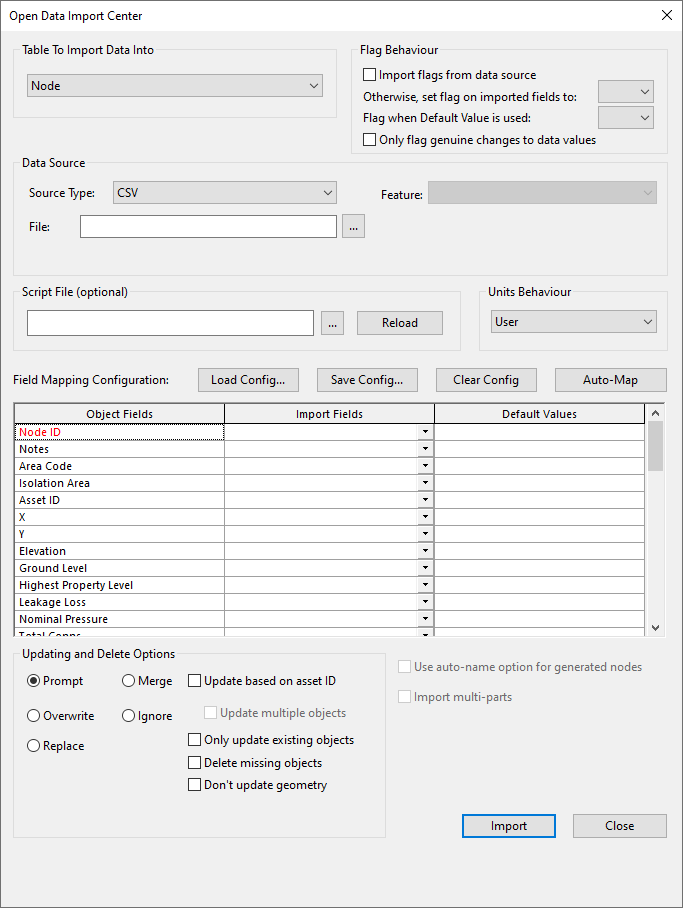

Open Data Import Centre dialog
This dialog is used to import data into an existing or new network.
To open the dialog when you want to create a network from scratch using external data:
To open the dialog when you want to add objects to an existing network from external data:
To open the dialog when you want to update an existing network from external data:
To open the dialog when you want to update the network or control in the Task Sequence editor:
Item Description
Table to Import Data Into
The database table into which you want to import data. You can only import data one table at a time.
Flag Behaviour
The flags to be set on imported data:
Import flags from data source
If checked, displays an additional Flag Fields column in the Assignment Grid.
This allows flag fields in the external data to be mapped onto flag fields in the selected table.
Otherwise, set flag on imported fields to
For selecting the flag to be used for imported fields.
The flag will be applied to all fields imported from the selected Data Source, that can be flagged.
If the Import flags from data sourcebox has been checked, the flag will be applied only to imported fields that do not have an imported flag.
Flag when Default Value is used
For selecting a flag from to apply to all fields in which the value has been set from the Default Values column of the Assignment Grid.
Only flag genuine changes to data values With this option checked, the flag value will only be changed if the incoming value differs from the current value by more than the display precision.
Data Source
This is for selecting the type of data you want to import. Once you have done so, you will need to enter other information, such as a file name, or GeoPlan layer name. You may also need to choose a data type or database table containing the data you want to import.
Source Type
The types of data you can import. Only valid data types are listed.
GeoPlan Layer
GIS data currently loaded as an additional layer on the GeoPlan.
CSV Format Data
A text file with the fields separated by commas.
Tab Separated Data
A text file with the fields separated by tab characters.
JET/Access Database
An Access (.mdb) database (also sometimes known as 'Jet database')
Oracle
For importing from Oracle databases.
The minimum version of Oracle supported for import without spatial data is Oracle 8i. To import spatial data a minimum version of Oracle 9.2 is required.
The following Oracle spatial geometries are supported or partially supported for import:
  • Point
  • Oriented Point - orientation vector is ignored
  • Multi-Point - first point only imported
  • Point Cluster - first point only imported
  • Line String - supported where points are connected only by straight lines
  • Polygon - supported where the boundary is connected only by straight lines or where it is a rectangle
  • Multi-Polygon - first polygon (connected by straight lines or a rectangle) only imported
  • Collection - first compatible element only imported (if present)
  • Multi-Line String - first line string only imported
The following Oracle spatial geometries are not currently supported for import:
  • Line Strings where the points are connected by arcs
  • Compound Line Strings
  • Polygons where the boundary is connected by arcs or is a circle
  • Compound Polygons
  • Complex Collections
GeoDatabase
A format for storing GIS data developed by ESRI.
For importing data from Personal GeoDatabases and ArcSDE. This option can also be used to import ESRI shapefiles.
Note: This option requires a licenced copy of ArcGIS™ installed on the computer on which the import is being performed.
ArcView Shape File (.shp)
MapObjects or ArcGIS shape file format.
This option is available only if using MapObjects as the current map control in the GeoPlan window.
MapInfo Tab File (.tab)
MapInfo Tab File format.
This option is available only if using MapX as the current map control in the GeoPlan window.
Raw Shape File
Data in the ESRI shapefile format.
Imports shape files directly instead of using any map control.
XML Format Data
A text file formatted in the eXtensible Markup Language.
JSON
A JSON file contains a number of tables. The JSON object within the file contains a number of arrays of objects (one array per table).
SQL Server
For importing data from a Microsoft SQL Server database, via the OLE DB Driver for SQL Server. See Select SQL Server Data dialog for connection details.
File GeoDatabase
Use this option to import data from File GeoDatabases. This option imports ESRI shapefile (SHP) folders.
Note: This option is only available for 64 bit versions of InfoWorks® WS Pro .
File
For certain types of data you will need to specify a filename. You can use the Browse button to find the file.
When importing from an Oracle database, this will display the Select Oracle Data dialog.
Feature
For certain types of data you will need to specify the feature. You can select the feature from the drop-down list.
When importing from an Oracle database, only tables for which the user has been granted the appropriate read permissions in Oracle will be available for selection.
When importing from a JSON file, the drop-down list will include all features in the JSON file.
Script File (optional)
You can use a script to control the import process more precisely. You can use this box to browse for the script file.
Note: Scripts are an advanced feature and not recommended for anyone without experience of programming in a scripting language.
To help you with writing your own scripts, you can use the Reload button to load the latest version of your selected script after making changes in an external editor such as Notepad. This allows you to adjust the script and test the changes without closing and re-opening the dialog.
See Using a script to control import of network data for more details.
Units Behaviour
You can use the options in this dropdown list to specify how units are handled during the import process. The options are:
InfoWorks The external data uses InfoWorks WS Pro native units
User The external data uses the currently defined user units for the network.
Custom
You can set the units used for each field in the imported data yourself.
An extra Units column is added to the Assignment Grid. You can then select the correct units from the options available in the dropdown list for each field.
Load Config
Load in a previously saved configuration (CFG) file. The file contains details only of the settings in the Assignment Grid. You need to set the other options on the dialog, such as the Select Table to Import into field, to match those used when the configuration file was saved.
Save Config
You can save all the settings in the Assignment Grid to a file (suffix CFG). These settings can then be reused for future imports.
Clear Config
You can clear all previous field mappings using this button.
Auto-Map
You can click this button to attempt to automatically map fields in the external data to fields in the database. Make sure you have chosen the appropriate table in the Select Table to Import into box before using this button.
InfoWorks WS Pro uses the standard field names used when exporting from InfoWorks WS Pro to try to link the fields up.
Assignment Grid
You can use this grid to define exactly how the external data should be imported into fields in the database.
Object Fields
This column lists all the fields for the current InfoWorks WS Pro object type, as selected from the Table to Import Data into dropdown.
Any field shown in red type is required for import. You must map at least these required fields.
You cannot change any of the fields in this column.
Import Fields
This column allows you to map fields in the external data to the InfoWorks WS Profields listed in the Object Fields column.
  • You can map the fields manually by choosing an external field in the dropdown list for each InfoWorks WS Pro field in the Object Fields column. You must map the required fields before you can import data.
  • You can try to map fields automatically by clicking the Auto-Map button. InfoWorks WS Pro will attempt to map the fields. The mapping is based on the names used for fields when data is exported to GIS from InfoWorks WS Pro.
  • When importing data from an Oracle database, to import spatial data, map the Oracle spatial data field to the Geometry Object field (highlighted in blue) in the Object Fields column.
Default Values
This column allows you to set values of fields directly as well as from external data.
On import:
  • If an external data field has not been mapped, the field for which the default value has been set will be assigned the value entered in the Default Values column.
  • If both an external data field has been mapped and a default value has been entered, the external data will be used where available. Where the external data contains a null value or a blank, the default value will be used instead.
Flag Fields
This column is displayed only if you have ticked the Import Flags from GIS checkbox.
Cells in this column are greyed out for data that cannot have a flag.
Units
This column is displayed only if you have chosen the Custom option for units behaviour.
You can choose the units for each field in the dropdown lists. Fields which do not require units information are greyed out.
Updating and Delete Options
The updating options allow you to decide how to handle duplicate objects in the external data.
Prompt
These options set the action to be followed when an object is encountered in the external data with the same name as an object already in the model.
Note: When importing arrays (for example, Reservoir: Depth Volume data), existing array data will be overwritten unless the Merge option is selected, in which case data will be appended to the existing array.
You will be asked whether or not you want to overwrite the current object every time a duplicate object is found in the external data.
Merge
Fills in any blank fields in the existing object with data from the imported object. Does not change any existing data.
Overwrite
Replaces data in the existing object with data from the imported object. (If the imported object does not contain data for a field, the existing data in that field will not be changed.)
Ignore
Ignores the imported object if it is a duplicate.
Replace Replaces the object.
Update based on asset ID
If this option is checked, InfoWorks WS Pro will look for duplicate objects using the Asset ID field and not the usual object identifier.
Note: When updating link objects using Object ID, the Link Suffix field of the object is used (in addition to the connected node IDs), to check for duplicate links. If connected node IDs match those of an existing link, but a link suffix is not provided, the Open Data Import Centre will create a new link object by incrementing the link suffix.
Update multiple objects
This option is enabled when Update based on asset ID is selected.
If this option is checked, multiple matching objects will be updated based on the asset ID.
If this option is not selected and you have multiple matching objects, InfoWorks WS Pro will display an error.
Note: Matching objects must have the same Asset ID value.
Only update existing objects
If this option is checked, InfoWorks WS Pro will only update existing objects. No new objects will be created on import.
Delete missing objects
If this option is checked, InfoWorks WS Pro will search for missing objects of the relevant type and delete them at the end of the import process. (A missing object is an object that is in the InfoWorks WS Pro Table to Import Data Into but is NOT in the external Data Source table.)
If the Update Based on Asset ID option is checked, the Asset ID field will be used to search for missing objects and not the usual object identifier.
All missing objects found will be listed and a prompt for confirmation of deletion will be displayed before any objects are deleted.
Don't update geometry
Check this box when you are updating ArcGIS, Oracle, or SQL Server.
If checked, existing objects will not have their geometry changed, even if the geometry has changed in the imported GIS data.
Use auto-name option for generated nodes
If checked, uses the automatic node name generation functionality for naming nodes that are generated when importing disconnected links. (See Using the open data import centre for more information.)
This option will be enabled only when automatic naming is switched on and an object for which nodes may be generated has been selected from the Table to Import Data Into section.
Import multi-parts
The Open Data Import Centre provides limited support for the import of polygons with multi-parts and complex shapes.
The option is enabled only when a polygon type table is selected and the data source selected is a GIS layer (from a file or from the GeoPlan).
Polygons will be imported in the following way:
GIS multi-part polygon
Do not import multi-parts: Imported as one polygon
Import multi-parts: Imported as three separate polygons
GIS polygon with hole
Import multi-parts: Imported as polygon with umbilical cord between two shapes
When importing multi-part polygons, the ID and area of the polygons will be generated automatically, regardless of the mappings entered in the Assignment Grid.
A maximum of 10 fields may be mapped in the Assignment Grid when using this option.
Import
Imports data based on the current settings.
Note: This option is not available when the Open Data Import Center is accessed from the Task Sequence editor.
Save
Saves all the selected options in the dialog, and adds them in the task sequence.
Note: This option is only available when the Open Data Import Center is accessed from the Task Sequence editor.
Close
Quits the importer.
