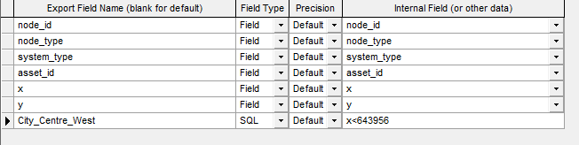

To export the result of a SQL expression using the Open Data Export Centre, select a Field Type of SQL and enter the SQL expression in the Internal Field (or other data) column in the Field Mappings Grid:
