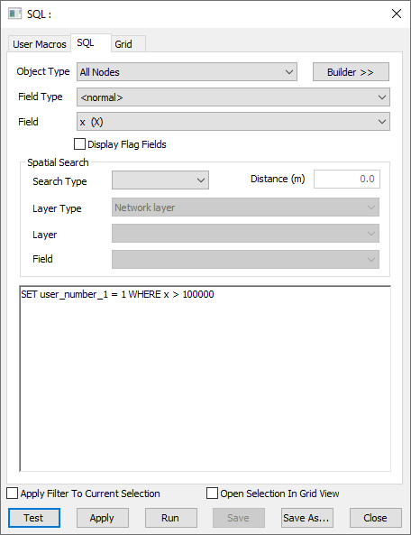

Example 1
SET
  user_number_1 = 1
 WHERE x > 100000
sets user_number_1 field to 1 for all objects of the chosen object type with x coordinate greater than 100000.

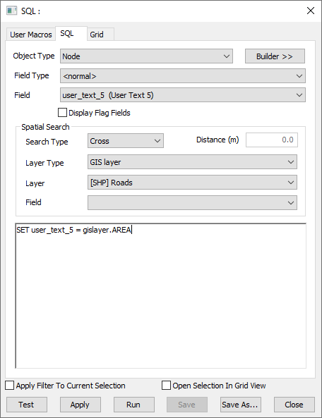

Example 2
SQL query context:
  • Object type: Node
  • [Spatial] Search type: Cross
  • [Spatial] Layer type: GIS layer
  • [Spatial] Layer: [SHP] Roads
SET
  user_text_5 = gislayer.AREA
This will set the user_text_5 field of any nodes inside a GIS polygon in the GIS Layer "Roads" to the value in the "AREA" field of the GIS polygon.
Important: This example utilises the Spatial Search functionality within SQL, specifically the implicit search functionality when defining spatial search options within the SQL dialog. See SQL and spatial searches for more information on including background Network and GIS layers in SQL queries.

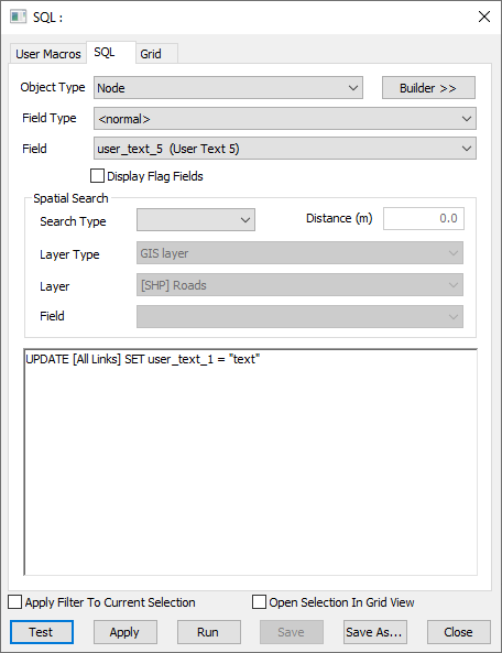

Updating a different object type
The UPDATE keyword is used in conjunction with the SET and WHERE keywords to update objects of one or more types, not necessarily the type selected in the Object Type list on the SQL dialog.
UPDATE <object type> SET
  <assignment>
  <assignment>
 WHERE <conditional expression>
Separate multiple assignments in the same statement by commas and separate multiple statements by semicolon, as described in Updating the current object type section above.
Example 1
UPDATE [All Links] SET
  user_text_1 = "text"
sets user_text_1 field to text for all link objects.
