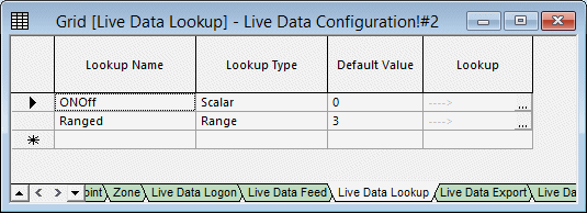

Live Data grid - Live Data Lookup view
The Live Data Lookup view is used to specify lookup tables that allow translation of external values coming from telemetry databases into internal values that will be correctly interpreted by InfoWorks WS Pro or IWLive Pro Operator Client.
The view is opened by double-clicking a live data configuration object in the Model Group window, then clicking the Live Data Lookup tab.
Notes:
Item Description
Left-most column
If clicked, selects the whole row.
A forward triangle indicates the current row.
An asterisk indicates where a new object can be created by entering its details (in this case, by entering a lookup name).
Fields
Lookup Name
User name for the lookup table. Lookup tables can be enabled for feeds in the Live Data Feed view.
Lookup Type
Type of the lookup:
  • Scalar - translates value A to value B
  • Range - translates a range of values to value B
Default Value
Optional.
Value used when there is no match for the external value.
If a default value is not set, a null value will be returned when there is no match for the external value.
Lookup
Clicking the ellipsis button displays the Live Data Lookup Editor.
Mapping or translation lists are entered in the editor, allowing external values provided by telemetry databases to be translated into values for use in InfoWorks WS Pro or IWLive Pro Operator Client.
Context menu option
Lookup Displays the Live Data Lookup Editor.
Properties
Displays the Live Data Lookup Object Properties window showing the properties for a single live data.
