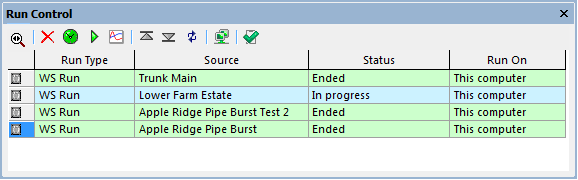

Run Control window
The Run Control window is for working with multiple runs in InfoWorks WS Pro. The Run Control window provides review and control over all runs that are in progress, or are pending, or have recently concluded. The Run Control window shows percentage complete for all runs that are in progress, shows the status and outcome for completed runs, and allows control over queued and current runs, including increasing priority (queue jumping).
When scenarios are selected in the Schedule Hydraulic Run dialog, the Run Control Window shows the entire run for multiple scenarios as a single row.
To make runs appear in the Run Control window, do any of the following:
When the run has appeared in the Run Control window, you can observe the run's progress slider and wait for the run to finish.

Run Control window job queue grid
Run type
The type of the run that has been submitted.
Source
The source of data that will be used as input for the run.
Status
The current status of the run.
A run passes through a range of states between submission and completion. Each state is associated with a colour that is used to colour the entire row:
  • White - indicates that the run is waiting in the queue
  • Blue - indicates that the run is being actively processed (e.g. pre-processing or actual job)
  • Red - indicates failure
  • Green - indicates success
Completed runs (in green) and terminated runs (in red) are held in a schedule as "recent history". You can clear this recent history as described above.
Run On
The name of the computer or agent group that the run is scheduled to run on.
If this is an agent group or 'Any computer', then once the run has started, the name of the computer is appended in brackets.
Validation
Shows whether full, partial, or no validation was applied to the run.
