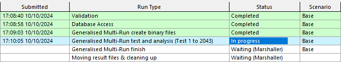

For multi-runs, the Job View window shows a single progress bar that deals with all test cases. Previously, there would be one progress bar for each cloud machine.
If you select the test case progress bar and go to the Job Progress view, you will see an updated count of the number of test cases queued, running and completed.
