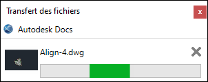

    • As you hold down your cursor and drag a document over the connected drive, a preview will be displayed.
    • After you release your cursor, a message box will be displayed while the documents and folders are being copied.
      Note: The Desktop Connector activities are displayed on the home screen. For more information, see Docs - Home Screen and Activities.
