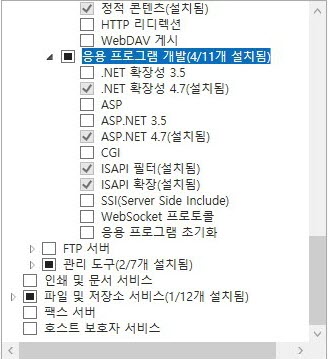

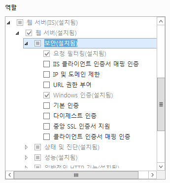

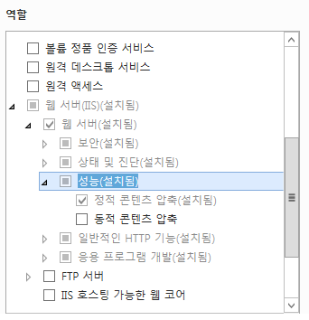

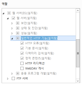

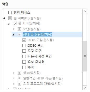

  7. 서버 역할 섹션에서 다음 역할을 선택합니다.
  8. 설치를 클릭합니다.

DISM.EXE /enable-feature /all /online /featureName:iis-WebServerRole /featureName:iis-WebServer /featureName:iis-CommonHttpFeatures /featureName:iis-DefaultDocument /featureName:iis-DirectoryBrowsing /featureName:iis-HttpErrors /featureName:iis-StaticContent /featureName:iis-HealthAndDiagnostics /featureName:iis-HttpLogging /featureName:iis-Security /featureName:iis-RequestFiltering /featureName:iis-WindowsAuthentication /featureName:iis-Performance /featureName:iis-HttpCompressionStatic /featureName:iis-WebServerManagementTools /featureName:iis-ManagementConsole /featureName:iis-ApplicationDevelopment /featureName:iis-ASPNET45 /featureName:iis-NetFxExtensibility45 /featureName:iis-ISAPIExtensions /featureName:iis-ISAPIFilter /featureName:iis-iis6ManagementCompatibility /featureName:iis-Metabase
